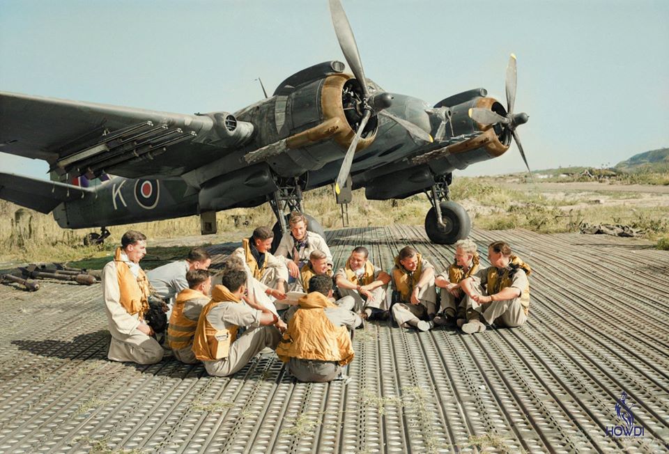

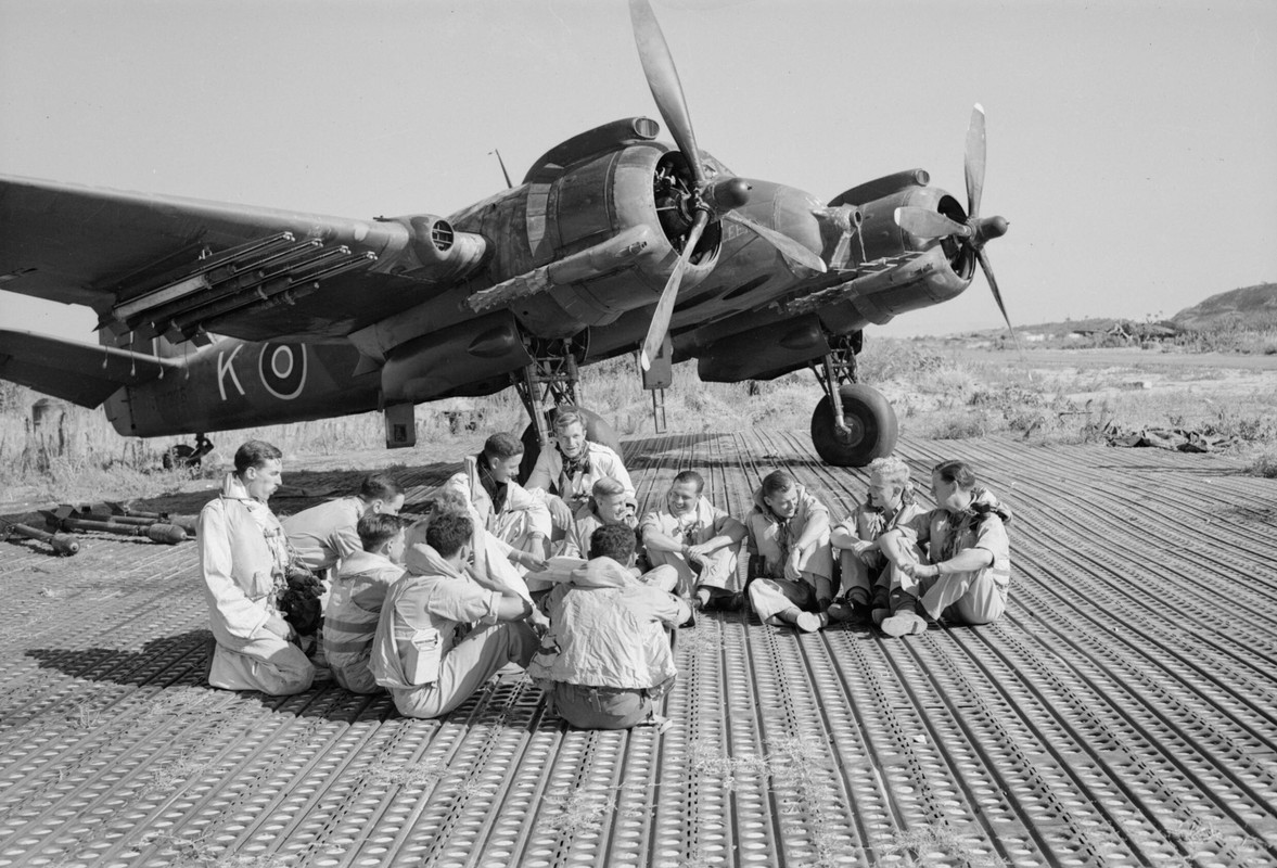

thanks a lot. I referr on this photo from wikipedia, when I enlarge it could really be LZ366 for the "K":
not colorised:

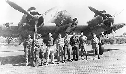

And I know that the colours are the RAF but on this photo the underside is quite dark, it should actualy be "sky" (upper surface extra dark sea grey and dark slate grey). And when i compare the gun camera in the nose it looks different than this one (252 Sqn RAF):
and this one (here is also the amblem which is on the Xtradecals sheet for the 19 Sqn):
So this 2 things I am still not sure.

PostPosted: 21 Apr 2021, 14:47
Posts: 8060
Did you colourise the photo?
I've been experimenting with a few online auto colourising sites this past week, but have not been happy with any of them.

Interesting to see the fin flash is reversed on the coloured photo!
Also that the centre of the roundel and fin flash is red and not orange.
No, I did not, have found it in the WEB,do not know where, but no i have found also another page:

Interesting to see that the fin flash is correct on the site that Airbus89 posted yet it's swopped around on the first photo! :shock:
