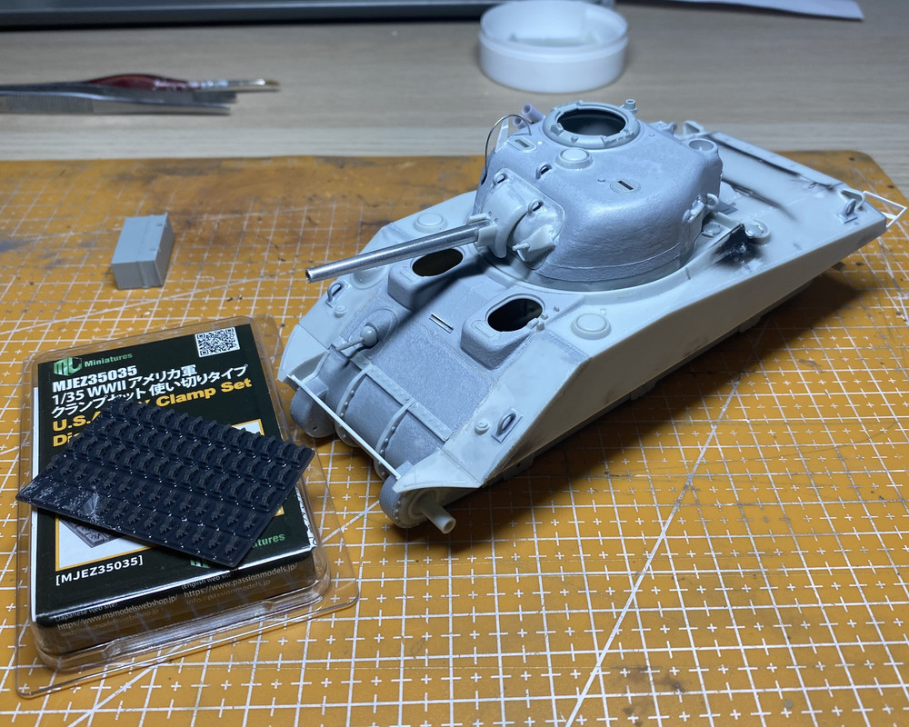

MJ miniatures tool clamps arrived so I gave them a try and I also added rounded bar around blade sight made out of metal wire. MG barrels were fitted together with MG shield on the turret according to photos. Rotor shield is still dry fitted.
